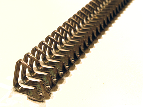

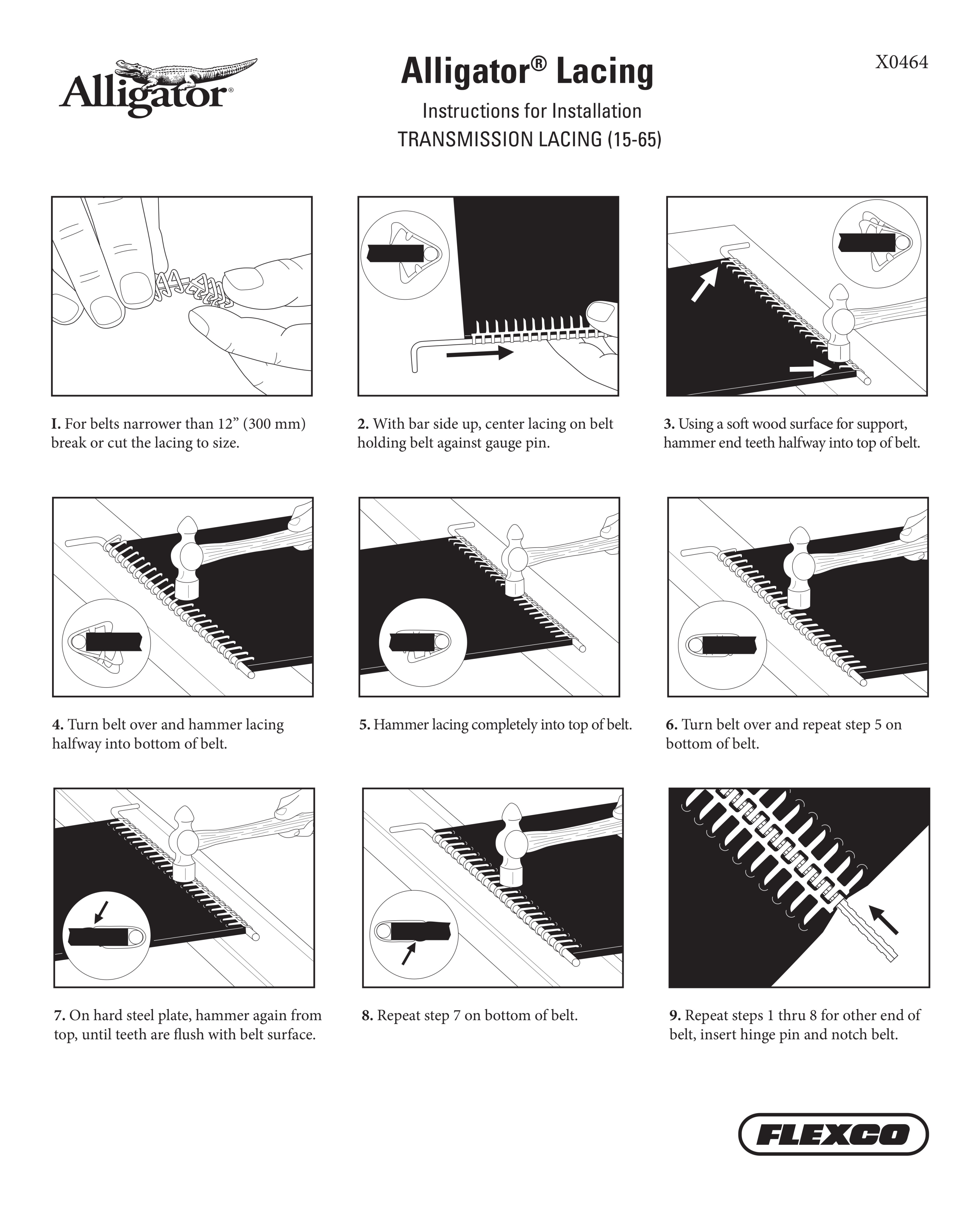

Alligator Belt Lacing - the Genuine American-made product not the inferior copy made in China. A length of clip is hammered in at each end of the belt and joined with two sections of the special oval pin supplied - these being designed to work back-to-back. Alternatively, a length of nylon or red-fibre rod can be used. A detailed instruction sheet is supplied with each clip. "Alligator clips" are made in various sizes but five cover most belts in common use.
All clips - save for the tiny No. 7 which is 6 inches long - are 11 inches long and supplied as a single strip complete with the special "dimpled" connecting pin.
THE No.7 CLIPS ARE SUPPLIED AS A PAIR with a connecting pin.
