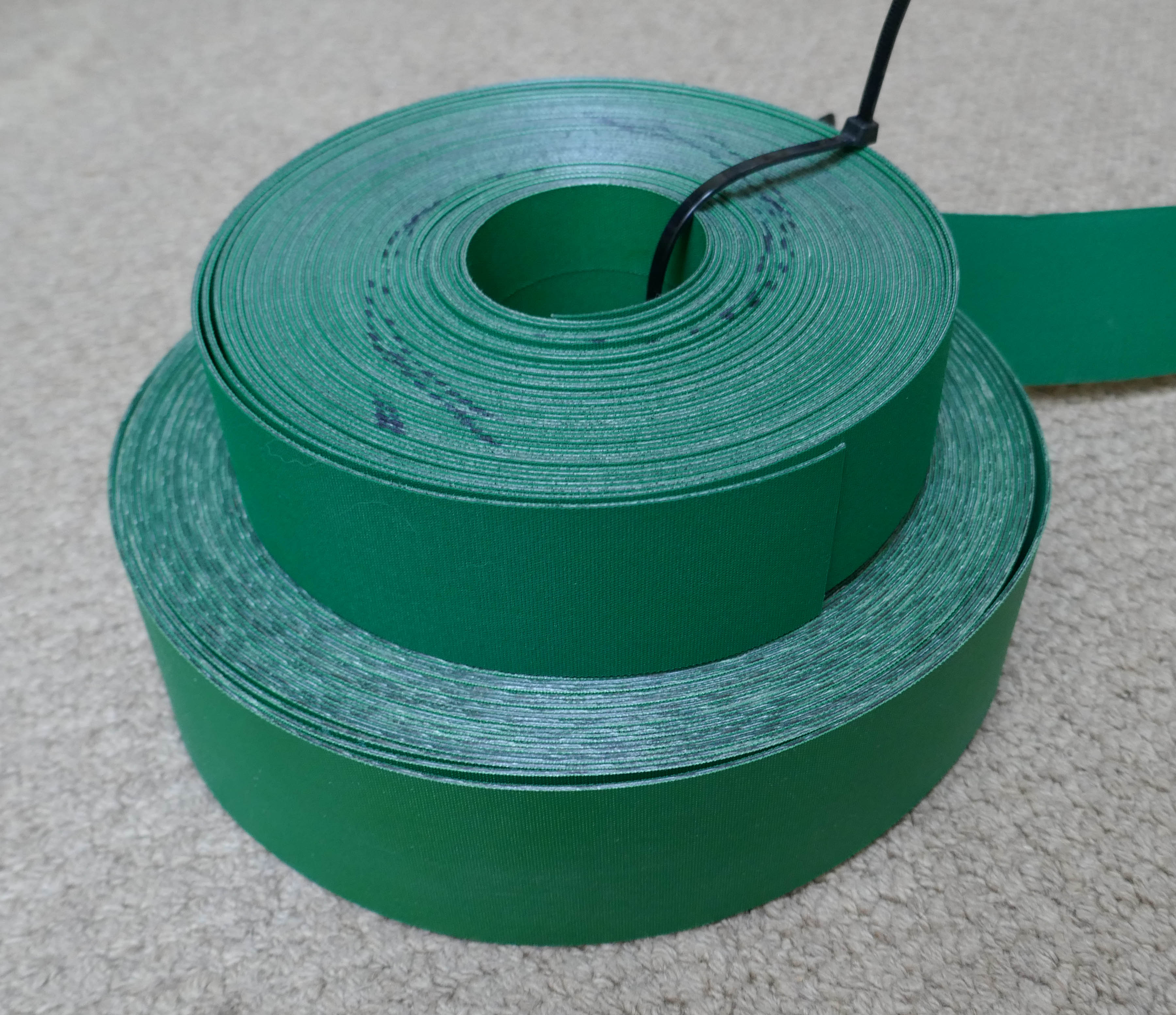

The ideal installation for any machine tool - especially high-speed drives - is a Swiss-manufactured Betalon-Multiply belt - made either endless or supplied as a DIY kit length with the ends scarfed and glue and instructions supplied. The glue is a very special type and supplied with each order where you need to assemble the belt on the machine. The resulting joint is smooth and tremendously strong.
These belts are light in weight but immensely strong and stretch resistant. They absorb shock loads well, have a high coefficient of friction, enjoy a proven record of reliable industrial service and can be made in almost any combination of length and width. Of course, if the belt is made for you as a loop, as with an ordinary V-belt, you may have to dismantle pulleys, etc., to fit it, but the trouble taken will be well worthwhile as the drive to your machine will be quieter, smoother and much more reliable.
