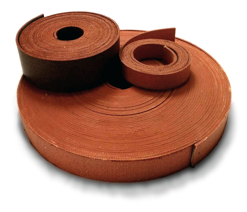

This belt (unlike cheaper alternatives cut from conveyor belts and cheap copies made in India) is enormously strong, UK-made, densely woven and specially designed for machine-tool use. The complete, ready-to-fit package you receive includes:
- The drive belt cut to your required length (it's supplied slightly over-length so you can cut to the exact size needed)
- A suitable length of Alligator clip and the connecting pin wide enough to join your belt. If you need additional clips - they're 11-inches long and in a size No.15 - they can be ordered below
- Clear and simple fitting instructions
