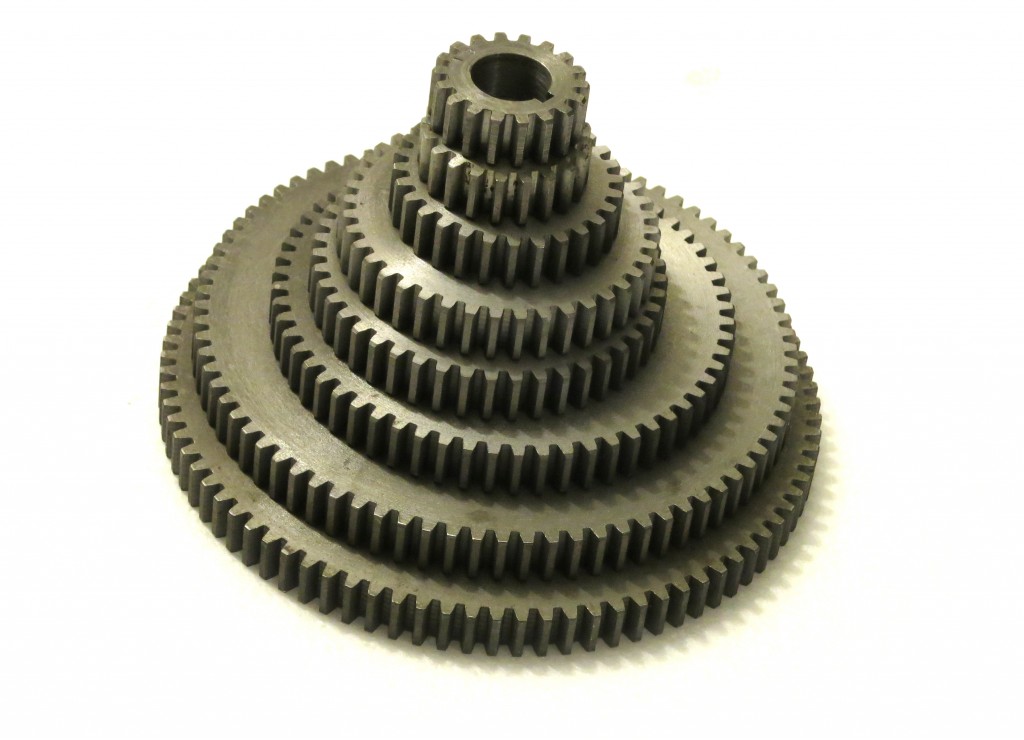

Changewheels (and metric-to-inch and inch-to-metric transposing gears) to fit Boxford and other South Bend 9-inch Clones (e.g. Ace, Hercus, Purcell, Smart & Brown Sabel, S and SAB, Blomqvist**, Parkanson, Purcell, Sheraton, Storebro**, etc). All are 18 D.P. with a 14.5-degree pressure angle and 0.125" depth of tooth. They are 3/8" wide with a 9/16" bore, and a 1/8" wide keyway. The idler and compound gears (two gears on one shaft) are different: they have a 5/8" bore with no keyway and are fitted to a hardened bush held in place with a through-bolt. Click in the "Teeth" box below to select the sizes required. Original Boxford and South Bend gears were in cast iron. However, 20t and below are now in steel for greater strength and reliability. Other Boxford gears are also listed, including the "2-pin" gear that fits into the headstock pulley to provide part of the backgear mechanism. While most changewheels are kept in stock for same-day dispatch, non-standard gears (i.e. never part of the original Boxford or South Bend set (and especially prime numbers) are made as one-offs and therefore cost more. The gears listed below are all used in the Boxford and South Bend sets - plus some that we've been asked to make for some special purpose.
The 127/100 inch-to-metric transposing gears are currently only available as separate gears that you would need to joint together - not a difficult job. They can be ordered here
The 135/127 metric-to-inch gears are in stock and can be ordered here.
We also have one or two unusual gears available secondhand: 33t, 37t, 39t, 42t, and 47t.
80T idler gears are now out of stock - but the standard 80T gear is easily modified - just bore the centre and machine up a spacing boss that needs to be 28.5 mm in diameter and 21mm deep. Any questions? Please phone and we'll be pleased to help: 01298-871633.
