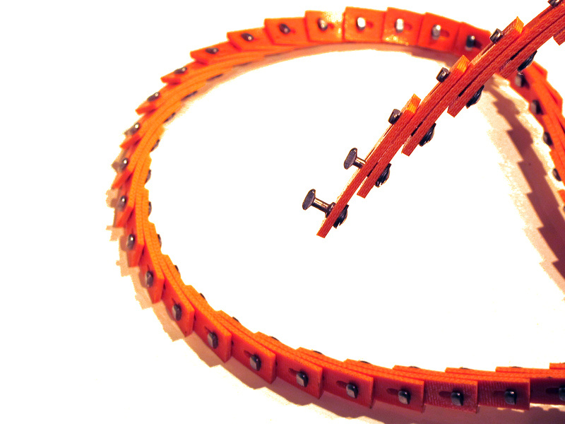

Final drive belt for Boxford Underdrive lathes. For this application, 1.4 metres of A-section Nu-T-link is needed.
This is the superior replacement for the original "Brammer" black-fabric round-end" link belt that was held together with mushroom-headed metal pins, each usually stamped with a letter "B". The new belts have only a slight curve to the end of each link, and the head of the pins is now a "T" section. Linking the belt - or the addition and subtraction of links - is very much easier; instead of needing special "opening pliers" to stretch the holes and get the pins through, the holes in the belt links are in the form of slots. The pins slip through very easily and simply need turning through ninety degrees with a pair of pliers to complete the job.  The belt also features significantly improved resistance to oil, heat, and steam.
In 2023, the price of this belt increased 30% - but this is the genuine American-made belt, not the inferior Chinese copy. The Chinese copy is smaller in section and can be recognised by the lack of a small dimple in the head of the joining pins.
